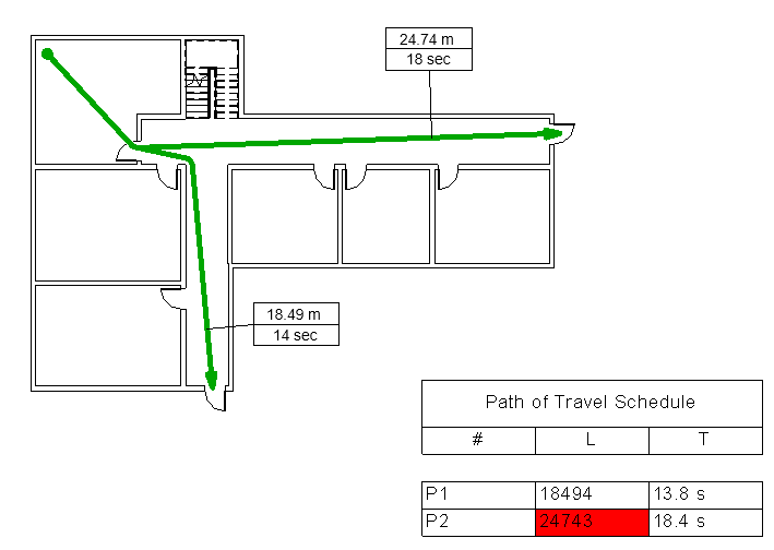

The path of travel element allows you to analyze travel distances and times between 2 selected points in your model. The path of travel is generated based on the model elements acting as obstacles along the path of travel. It avoids contact with model elements in the analysis zone and calculates the shortest distance between the start and end points.
