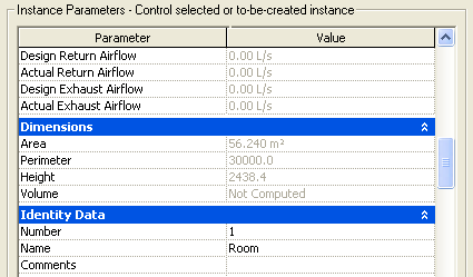

Parameter
Every element has a set of parameters that users can view and edit in Revit. The parameters are visible in the Element Properties dialog box (select any element and click the Properties button next to the type selector). For example, the following image shows Room parameters.
Figure 25: Room parameters
In the Revit Platform API, each Element object has a Parameters property, which is a collection of all the properties attached to the Element. You can change the property values in the collection. For example, you can get the area of a room from the room object parameters; additionally, you can set the room number using the room object parameters. The Parameter is another way to provide access to property information not exposed in the element object.
