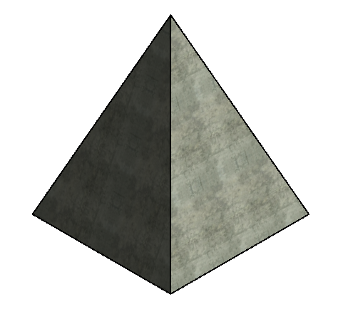

Code Region: Create a DirectShape using TessellatedShapeBuilder
// Create a pyramid-shaped DirectShape using given material for the faces
public void CreateTessellatedShape(Document doc, ElementId materialId)
    List<XYZ> loopVertices = new List<XYZ>(4);
    TessellatedShapeBuilder builder = new TessellatedShapeBuilder();
    builder.OpenConnectedFaceSet(true);
    // create a pyramid with a square base 4' x 4' and 5' high
    double length = 4.0;
    double height = 5.0;
    XYZ basePt1 = XYZ.Zero;
    XYZ basePt2 = new XYZ(length, 0, 0);
    XYZ basePt3 = new XYZ(length, length, 0);
    XYZ basePt4 = new XYZ(0, length, 0);
    XYZ apex = new XYZ(length / 2, length / 2, height);
    loopVertices.Add(basePt1);
    loopVertices.Add(basePt2);
    loopVertices.Add(basePt3);
    loopVertices.Add(basePt4);
    builder.AddFace(new TessellatedFace(loopVertices, materialId));
    loopVertices.Clear();
    loopVertices.Add(apex);
    builder.CloseConnectedFaceSet();
    builder.Target = TessellatedShapeBuilderTarget.Solid;
    builder.Fallback = TessellatedShapeBuilderFallback.Abort;
    builder.Build();
    TessellatedShapeBuilderResult result = builder.GetBuildResult();
    using (Transaction t = new Transaction(doc, "Create tessellated direct shape"))
        t.Start();
        DirectShape ds = DirectShape.CreateElement(doc, new ElementId(BuiltInCategory.OST_GenericModel));
        ds.ApplicationId = "Application id";
        ds.ApplicationDataId = "Geometry object id";
        ds.SetShape(result.GetGeometricalObjects());
        t.Commit();
The image below is the result of running the example above with a concrete material id specified.
