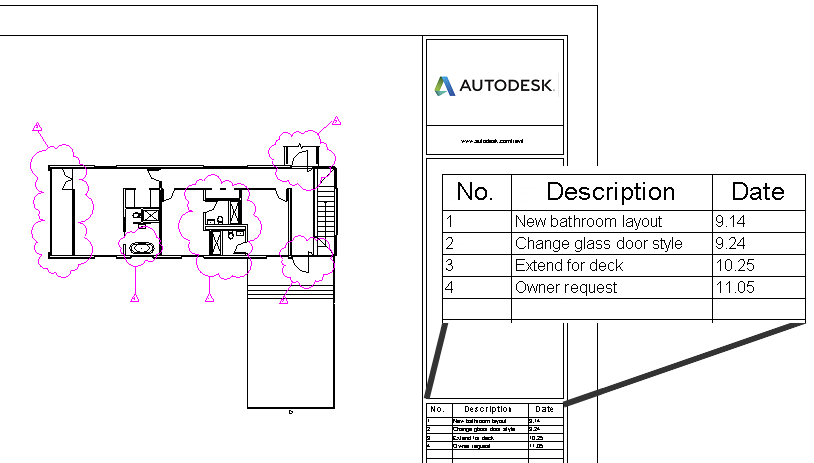

Use a title block that includes a revision schedule to display a revision schedule on a sheet.
Most title blocks for sheets include a revision schedule. When you place a view on a sheet and the view includes revision clouds, the revision schedule automatically displays information about those revisions. If desired, you can specify that other revisions (not represented by revision clouds in the view) are to display in the revision schedule.
To display a revision schedule on a sheet, use a title block that includes a revision schedule. When designing the revision schedule, you can specify its format, orientation on the page, information that it displays, and sort order. You control these attributes of the revision schedule by modifying the title block family.
