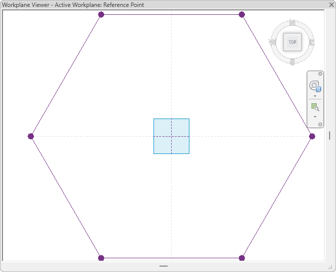

The sample images in the following procedure use this sweep as the starting point:
To edit with the Workplane Viewer
  1. Select a work plane or element profile.
  2. Select Modify | <Element> tabWork Plane panel Viewer.
    The Workplane Viewer opens to the appropriate 2D view zoomed to the extents of the model.
  3. Edit the model as needed.
When you make changes in a project view or in the Workplane Viewer, other views are updated in real time.
