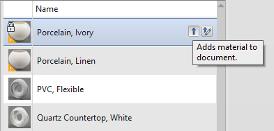

The libraries supplied by Autodesk are locked, as indicated by a lock icon. Materials in a locked library cannot be overwritten or deleted. You can copy materials from a locked library to unlocked user-created libraries, where materials can be overwritten or deleted. In the following figure, the AB Project Materials library is an unlocked user-created library.

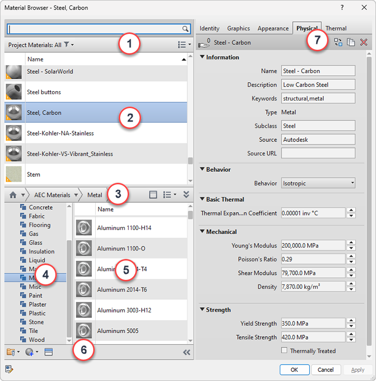

To work with libraries, access the Material Browser by clicking Manage tabSettings panel (Materials).
Region Function
1 Project materials filter : Filter project materials by class. Show/Hide project materials settings menu : This button lets you modify the view of project materials and the library panel in the Material Browser window. Use the project materials settings menu options to filter the display of materials presented in the project materials list.
2 Project materials list: Displays materials in the current project, whether they are applied to objects or not. Select materials from the list and then Right-click to access a menu of common tasks such as Rename, Duplicate, and Add to a Library.
3
Material Libraries toolbar: Provides controls to manage libraries, create new or duplicate existing materials, or open and close the Asset Browser. Show/Hide Library Tree and Library settings menu : These 2 buttons let you modify how libraries and their materials, are displayed in the Material Browser window. Click the Show/Hide Library Panel Tree to show or hide the display of the library tree. You may need to hide the display of the library tree to provide more space for viewing library materials. Use the library settings menu options to filter the display of materials presented in the library materials list.
4 Library list: Displays open libraries and categories (classes) within libraries.
5 Library materials list: Displays materials in the library or category (class) selected in the library list.
6 Material Browser Toolbar: Provides controls to manage libraries, create new or duplicate existing materials, or open and close the Asset Browser.
7 When a material is selected in the library list (left pane), this right pane displays the tabs (assets) associated with this material. Click the tabs (for example, Identity or Appearance) to view the properties and assets of the material. When viewing materials in libraries, properties are read-only.

  • Select the material in the library list, and then click the Add button located to the right of the material.
