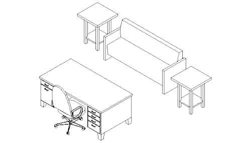

You can group elements in a project or family and then place that group many times in a project or family.
Video: Creating Groups
Grouping elements is useful when you need to create entities that represent repeating layouts or are common to many building projects, such as hotel rooms, apartments, or repeating floors.
With each instance of a group that you place, there is associativity among them. For example, you create a group with a bed, walls, and window and then place multiple instances of the group in your project. If you modify a wall in one group, it changes for all instances of that group, simplifying the modification process.
