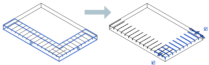

Expose the individual hosted rebar created by path reinforcement.
Note: This tool is only available when hosting rebar in path reinforcement.
  1. Select the path reinforcement system.
  2. Click Modify | Structural Path Reinforcement tab Path Reinforcement panel (Remove Path System).
    The path reinforcement system with any symbols and tags is removed from the project leaving rebar and rebar sets in place.
