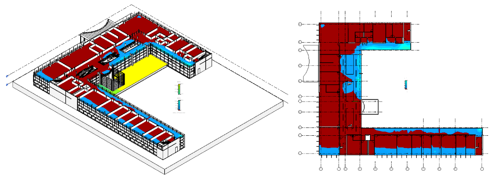

Apply a colorized result and legend to 3D and plan views of your models to visualize analysis results.
An analysis result is applied to a view to visualize the results. A legend is also applied to the view as part of the analysis result.

- Review and then close the Lighting Analysis - Results Summary Dialog.
- Open a view with a
"_InsightLighting" prefix to the name.
Note: When you create a lighting analysis, a 3D view, plan views and schedule views are created with the prefix _InsightLighting. These views are where lighting analysis results are applied. Examine 3D, plans, and schedules to understand the results of the lighting analysis.
