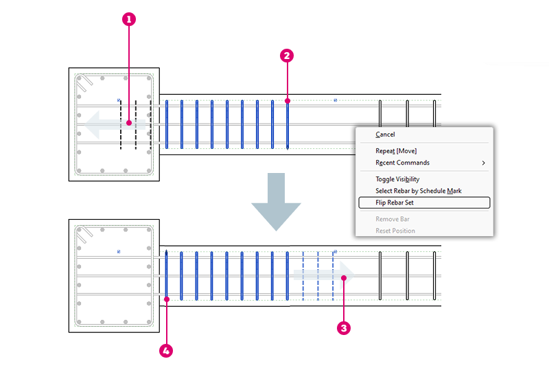

Flip Rebar Set Direction
  1. Select the rebar set you want to flip.
  2. Right click and select Flip Rebar Set from the menu.
  3. The first bar of the set is now the one at the opposite end of the set.
Expansion direction for set.
First bar in Number with Spacing set.
First bar in Number with Spacing set after flip.
