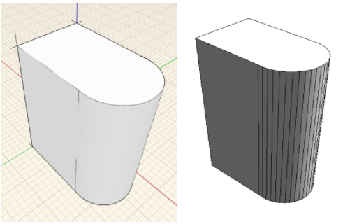

- Curved faces in
FormIt are imported to
Revit as faceted faces.
