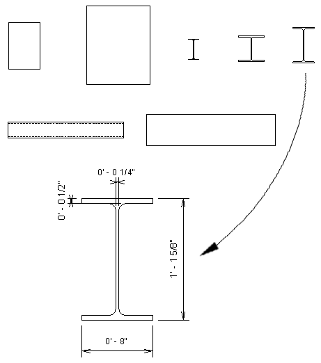

Add dimensions to individual legend components to make them more descriptive.
You can add dimensions to individual legend components using the Dimension tool.
You can dimension to most lines within a legend component. However, you cannot dimension to host components, such as walls, ceilings, and floors. Likewise, you cannot dimension system family components within a legend.
Window legend with first window dimensioned
Structural component legend with third wide-flange column dimensioned
