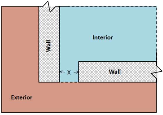

The maximum distance between Revit elements that may be ignored in the identification of energy analytical model spaces is 2 times the Analytical Space Resolution setting.
This concept can be illustrated as follows, where the plan view shows 2 walls bounding an interior space with a gap between them of dimension X.
If Analytical Space Resolution = 18 inches (457.2 mm), then:
- If X < 18", then the gap will be ignored and the analytical space will be created.
- If X > 18" and < 36" (914.4 mm), then the gap may or may not be ignored.
- If X > 36", then the gap will not be ignored and the analytical space will not be created.
