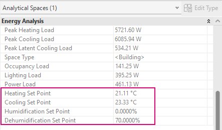

You can edit the set point values. Note that the Heating Set Point must be at least 1 degree F (0.56 degrees C) below the Cooling Set Point. Likewise, the Humidification Set Point must be at least 1% below the Dehumidification Set Point.
After creating the energy model, the set points in the Building Type settings are applied to the analytical spaces and display as read-only in the Properties palette. Set points assigned on a system zone will override the settings from the building type for all analytical spaces assigned to the system zone.
The set points may be overridden by using a Space in the same location as the analytical space. The values in the Space Type settings will be applied to the analytical space.

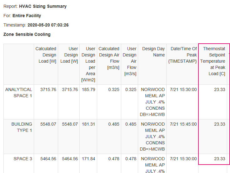

These set points are used when running a systems analysis. After running a sizing analysis, the Cooling and Heating Set Points display in the HVAC Sizing Summary of the analysis report.
