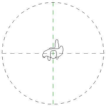

Use the People Content family to indicate occupants in a space and a physical distance radius around them to be considered during route analysis.
The people content family is used to indicate occupancy in your model. The radius included in the family blocks the path of travel during route analysis.
Important: When working with people content in your models remember the following rules:
  • The nested generic model family "Metric Physical Distance Circle" is calculated as an obstacle during route analysis.
  • The parameter "Elevation from Level" in the nested generic model family "Metric Physical Distance Circle" must be set to a value greater than 300mm to be considered during route analysis.
  • The type parameter "Physical Distance Radius" sets the size of the nested family "Physical Distance Circle".
  • The type parameter "Physical Distance Circle Visibility" controls the visibility of the nested family "Physical Distance Circle". The family must be visible to be considered during route analysis.
