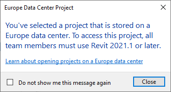

Review the following information if you receive a warning when accessing a Revit 2021.1 model in P&ID Modeler that is stored on a Europe data center.
Cause: Revit releases prior to 2021.1 are unable to connect to Europe data center locations, so users of prior Revit releases must select a project on a US data center. When you select a Plant 3D project stored on a Europe data center in Revit 2021.1, users of prior Revit releases are unable to connect to the Plant 3D project.
Solution: If you are accessing a Plant 3D collaboration project stored on a Europe data center, it is imperative that all collaborators working in that model use Revit 2021.1 or later.
