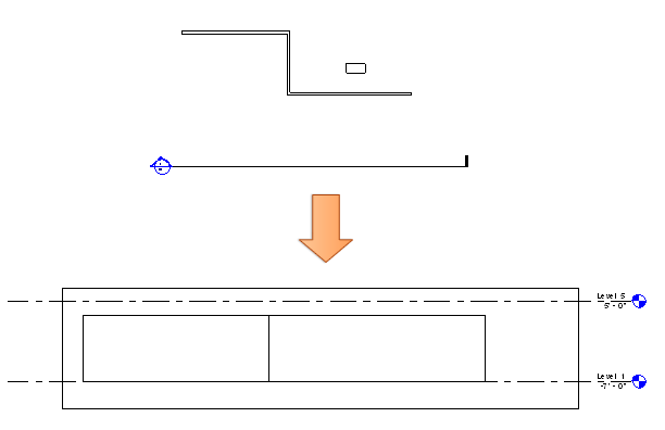

The following example shows splitting a section, but the same approach can be used for an elevation. In the following figure, a typical section is drawn on the model.
Modify the section as shown and the resulting section view changes.
