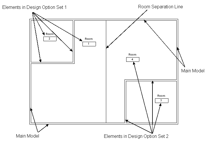

If you want the shape, size, or location of a room to vary among different options of multiple option sets, do the following:
- In the main model, use room separation lines to divide the space into rooms. (Do not, however, add room elements to the main model.)
- Create one option set for each of these rooms.
- In the design options for a set, add the rooms.
You can then create dedicated views to display different combinations of the design options from each set. (See Dedicate Views to a Design Option.)
