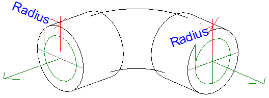

  • Use reference lines to control the angle of a curve of an elbow fitting.
    An elbow pipe fitting family with an angle controlled by a reference line
