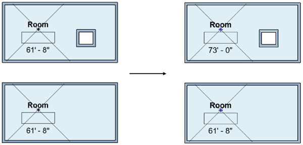

Room Perimeter Calculations
Additionally, the method for calculating the perimeter of round rooms or room with arc segments has been enhanced to ensure greater accuracy.
Please note that when upgrading models from earlier versions of Revit LT, it is possible to observe changes in the perimeter values of rooms, depending on the geometry involved.
