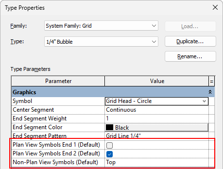

To show or hide grid bubbles using type properties
  1. Open a view that displays grid lines.
  2. Select a grid line, and click Modify | Grids tabProperties panel (Type Properties).
  3. In the Type Properties dialog, do any of the following:
    • To display grid bubbles at the start point of grid lines in a plan view, select Plan View Symbols End 1 (Default).
    • To display grid bubbles at the endpoint of grid lines in a plan view, select Plan View Symbols End 2 (Default).
    • In views other than plan views (such as elevations and sections), indicate where to display grid bubbles. For Non-Plan View Symbols (Default), select Top, Bottom, Both (top and bottom), or None.
  4. Click OK.
    Revit updates all grid lines of this type in all views.
