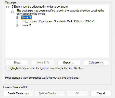

List All Errors and Warnings Associated with an Error Message
In an error dialog, click Expand to view a tree structure listing the errors and warnings associated with your last action.
To see more information about each error, click the plus sign (+) in the tree structure.
You can also do the following:
  • Select an error heading, such as Error 1. All elements associated with that error are selected in the drawing area.
  • Select an element in the list to see it selected in the drawing area.
  • With an element selected in the list, click Show to search views for that element only.
  • Delete an element by selecting its check box and clicking Delete Checked.
  • Return the error dialog to the normal view by clicking Collapse.
