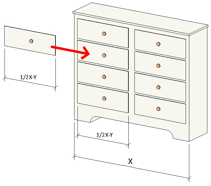

  • In a wall-mounted shade family, the support is a nested family to make the control the geometry in the array easier. The number of required supports are arrayed based on the length of the shade when placed. The Support Length parameter defines the distance the support extends from the wall, and its value needs to be passed to the support's nested family geometry.
  • A chest of drawers has drawers as nested family. The Width parameter of the chest family is passed to the nested drawer family, to allow it to fit correctly in the chest opening.
