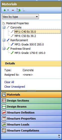

The order of the materials in the Active Group Tree List may be toggled between:
- View by reference: The materials are listed in order of their reference number ('MP1', 'MP2', etc)
- View by type: The materials are listed in order of their material type.
Form Graphic
