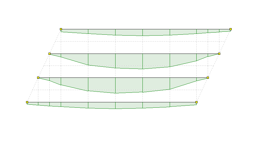

Graphic for Single Effect or All Effects

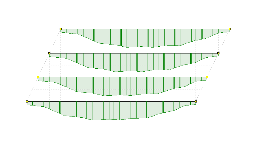

Graphic for Property Set
