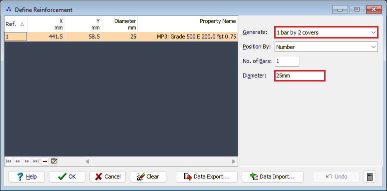

  6. Change the Generate option to “1 bar by 2 covers” and change Diameter to “25mm”.

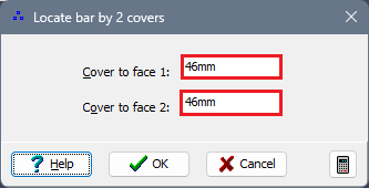

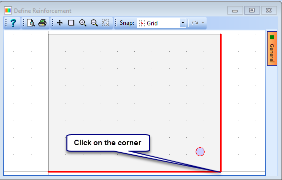

  7. Click on one of the corners of the rectangle in the graphics window to display a data form allowing the definition of the reinforcement cover. Set this cover to “46mm” on both faces and then close the form using ✓ OK.
    Define Reinforcement Locate bar by 2 covers
  8. Repeat step 9 for the other three corners noting that the cover is automatically set to the last defined.

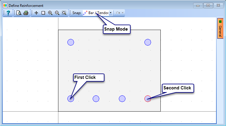

  10. In the graphics window toolbar, set the snap option to “Bar/tendon” then click on the bottom left hand bar in the graphics window followed by the bottom right hand bar. This will create an extra 4 bars, 2 of which will be superimposed on the corner bars.
  11. Repeat this with the two top corner bars.
  12. Change the No. of Bars to “3” and draw in the bars along the remaining two vertical edges in the same way.

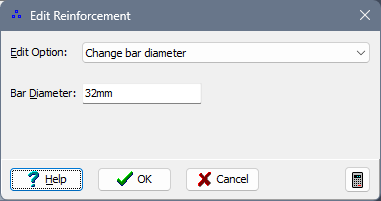

  16. Click on the Edit bars button at the bottom of the table and a secondary Edit Reinforcement form should be displayed. Change the Edit Option to “Change bar diameter” and set the Bar Diameter to 32mm. Close the Edit Reinforcement form using the ✓ OK button and the bars are updated.
