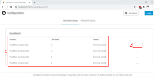

Configuring job limits
Switch to the Configuration page to change the concurrency limit for a job type on the local machine. Jobs submitted to the local Queue will remain in a Pending state until there is capacity on the local machine. Be aware that a remote Provisioner registered with the local Queue may pick up jobs in a Pending state.
  1. List of current job types, their concurrency limits, and the number of currently running jobs on this machine.
  2. Click the ellipsis to edit the limit for a particular job.
