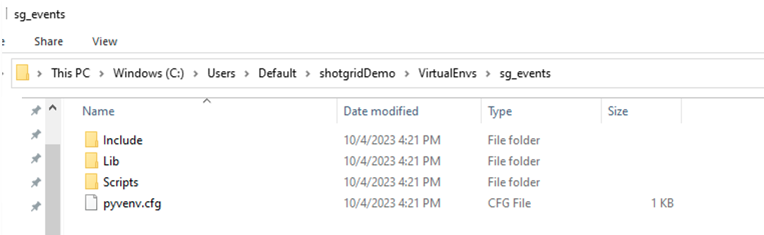

python -m venv .\sg_events
Once run, the python command will create several new directories within the sg_events folder. You should have something like the image below.
New folders have been created

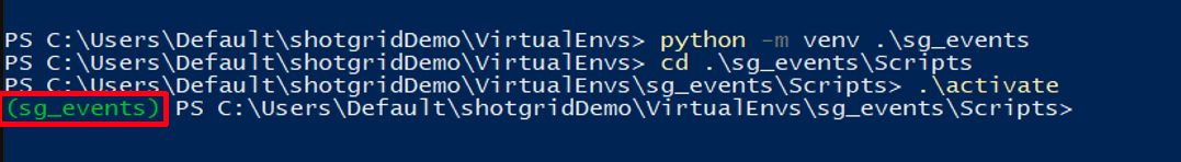

Activate the virtual environment.
.\activate
The virtual environment should now be active, indicated by parentheses.
