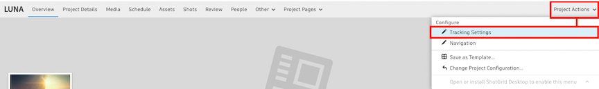

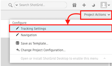

To see what Entity types and fields exist within a particular Flow Production Tracking Project, open the Project in Flow Production Tracking and select Project Actions > Tracking Settings.
Tracking settings

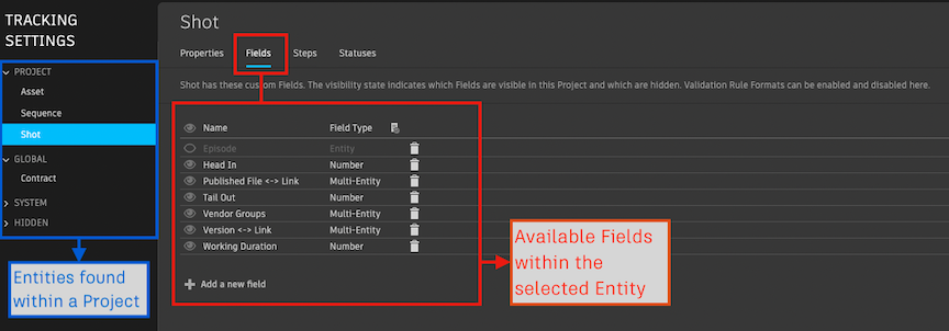

On the left-hand side, you can see a list of all the Entities that exist on a particular Project in Flow Production Tracking. Some entities will be Project-specific, while others will apply globally to all Projects.
On the right-hand side, select Fields to see a list of the currently existing fields within each Entity. It should be noted that from this page, the displayed fields will show you their Field name, and not their Field code.
See available fields

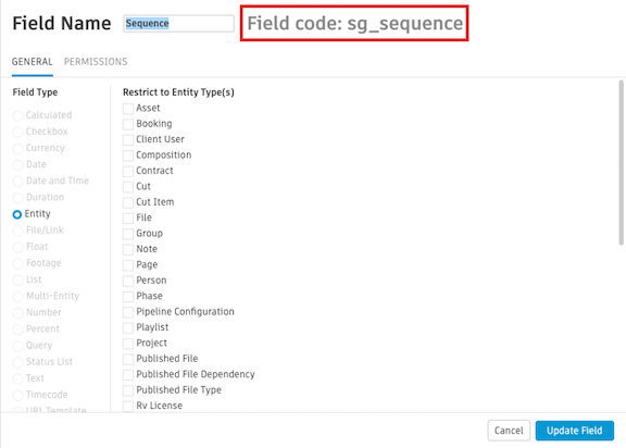

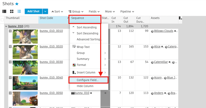

To get more information about each Field, including the Field code, open the Project in Flow Production Tracking, go to a page where the Field can be found, right-click over the header, and select Configure Field. In the example below, to find the field code for the Sequence field of the Shot Entity, go to a Shot Entity page and find the Sequence field.
Configure fields
The Field code will be displayed to the right of the Field Name. In the example below, the Field code for the Sequence field is sg_sequence.
See the field code

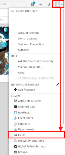

Alternatively, you can also find this information by going into the Fields page from the Admin menu and searching for the name of the Field name you want more information about.
Find Fields from the Admin menu

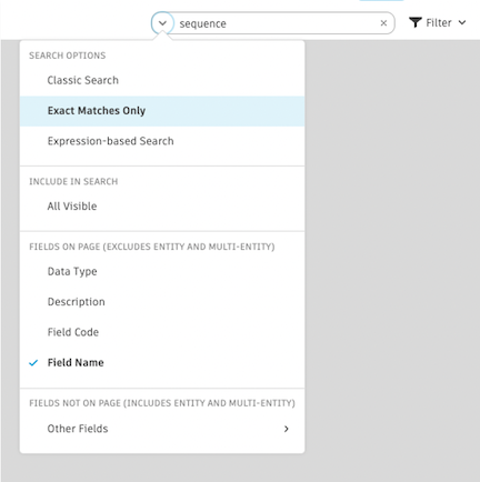

From the Fields page, use quick search to find the field you’re looking for. In this example, we will look for the same field as above – the Sequence field of the Shot entity.
Search for the field you're looking for

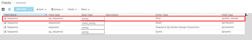

The results show four fields with the same Field Name. Since we are looking for the Sequence field of the Shot entity, we can use the Entity Type field to determine which of these fields is the one we’re looking for. The Field Code field will tell us the field code, which is sg_sequence.
See a list of fields

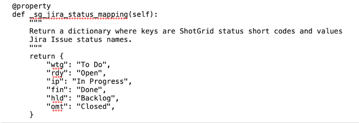

In the mapping, the statuses being used from Flow Production Tracking are the status short codes. All statuses in Flow Production Tracking have a Name and a Short Code. For example, the status name Waiting to Start has a short code of wtg.
In the image below, the left side represents the Flow Production Tracking status short codes, while the right side represents the Jira statuses they will correspond to.
See status short codes

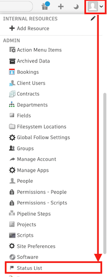

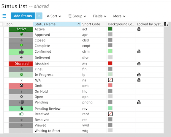

To see the available statuses on your Flow Production Tracking site, from the Admin menu on the top-right of the site, select Status List.
Go the Admin menu to find the Status List
The Status List page will display all statuses available on a Flow Production Tracking site, including their Names and Short Codes.
See the statuses on your site

To see the statuses being used on any Entity within a specific Flow Production Tracking Project, from within the Project, select Project Actions > Tracking Settings.
Tracking settings

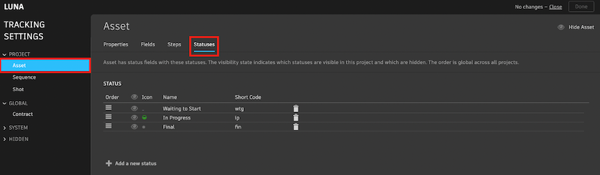

From within a Project’s Tracking Settings, select the Entity in the left-hand pane and select Statuses on the right-hand pane.
See statuses
You should now see the available statuses for a specific Entity on the chosen Project.
