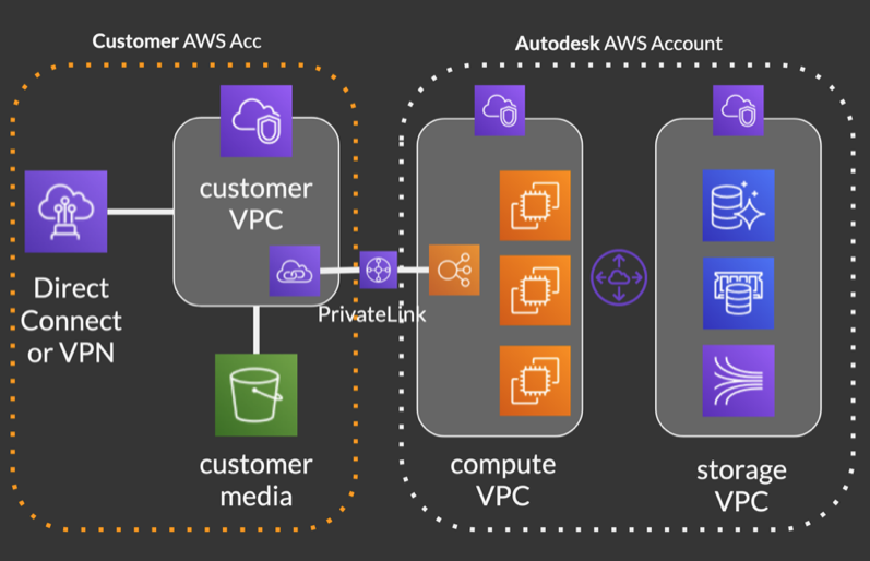

Plan the VPC IP ranges
Plan your AWS VPC and subnets IP ranges if you plan to use Media Traffic Isolation.
IP Range Example
| Region | VPC | Subnet 1 | Subnet 2 | Subnet 3 |
| ap-southeast-2 | 10.1.0.0/16 | 10.1.0.0/24 | 10.1.1.0/24 | 10.1.2.0/24 |
Plan how you will privately access your AWS VPC
If you plan to activate any of the Traffic Isolation feature, you will need a way to connect your AWS VPC and your network infrastructure. The main options are:
- AWS Direct Connect
- Other VPN solution
We highly recommand you to leverage Direct Connect. Direct Connect guarantees the lowest latency possible to the Flow Production Tracking services, a consistent network experience, and allow you to leverage the optimization AWS is relying on to guarantee an optimal performance across the globe.
