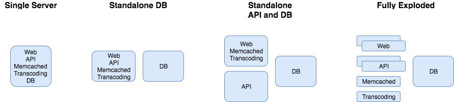

Flow Production Tracking Enterprise Docker (SE Docker) can be configured and deployed in many different ways. Flow Production Tracking components can be spread out on multiple servers, allowing Flow Production Tracking to scale with users and load.
Single server - Standard configuration; all of Flow Production Tracking components running on the same server.
Standalone DB - Database running on its own server. Recommended if you expect more than 100 users.
Standalone API and DB - In this configuration, API (script) requests are handled by a dedicated server. The database is also running on its own server. Intended for heavy API users.
Fully exploded - Flow Production Tracking can scale heavily by increasing the number of App Servers handling requests. Memcached and the Transcoder can also be running on dedicated servers.
Flow Production Tracking topology can be modified later on if the limitations of the initial setup are reached, but it requires downtime.
Multiple App Servers and API Servers can be set up, but these kind of configurations are usually reserved for advanced users. If you feel that you should have an advanced setup, let us know in your setup support ticket and we will discuss the options.
