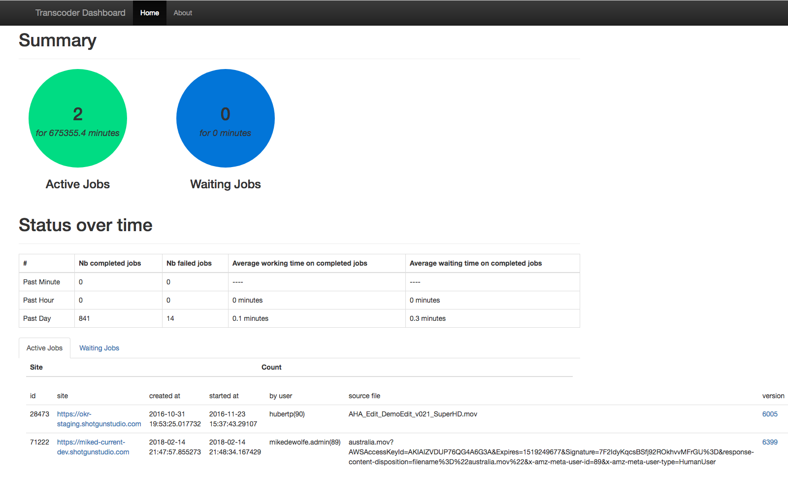

The transcoding dashboard provides information about the transcoding jobs, such as a summary of the active and waiting jobs along with a detailed list of these jobs and a status table of jobs over time.
The dashboard is available at the following URL:
 http://<transcoderserver_hostname>:8008/dashboard
By default, the dashboard will not be exposes to the outside. Make sure that the firewall rules of the server hosting the transcoding-server allows incoming HTTP connections to port 8008.
The dashboard is available in transcoder-server version 6.0.6 and up.
