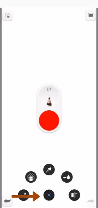

Accessing the Brush Library from a handheld device
  1. Tap Brush Library icon on the 64-bit iPhone to access the Brush Library and an assortment of brush sets.
  2. Flick up or down within the editor to reveal more brush sets. If you see sliders, instead of brushes, at the top of the screen tap Library to return to the Brush Library.
  3. Tap the X at the bottom of your screen to close the library.
