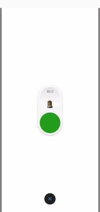

To undo an action, do one of following:
  • For all users of SketchBook Pro Mobile, double-tap the bottom left corner of the screen.
  • For handheld device users, tap Clutch, then Undo icon to undo an action or Redo icon to redo an action.
