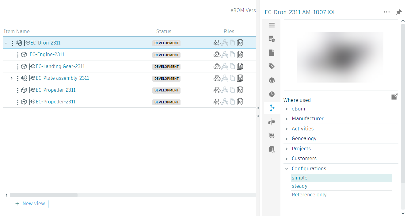

In the Upchain web application, a configuration item is indicated by a configuration icon config_icon.png beside the item type icon.
In the item detail view, the Where Used tab contains an additional section named Configurations that lists all other configuration items to which the selected item is linked, and highlights the configuration for the item you are viewing. You may click any of these linked configurations to be taken to that item. If the configuration belongs to multiple projects or BOM locations, Upchain presents you with a window to select to which location you'd like to navigate.
web view of configs
