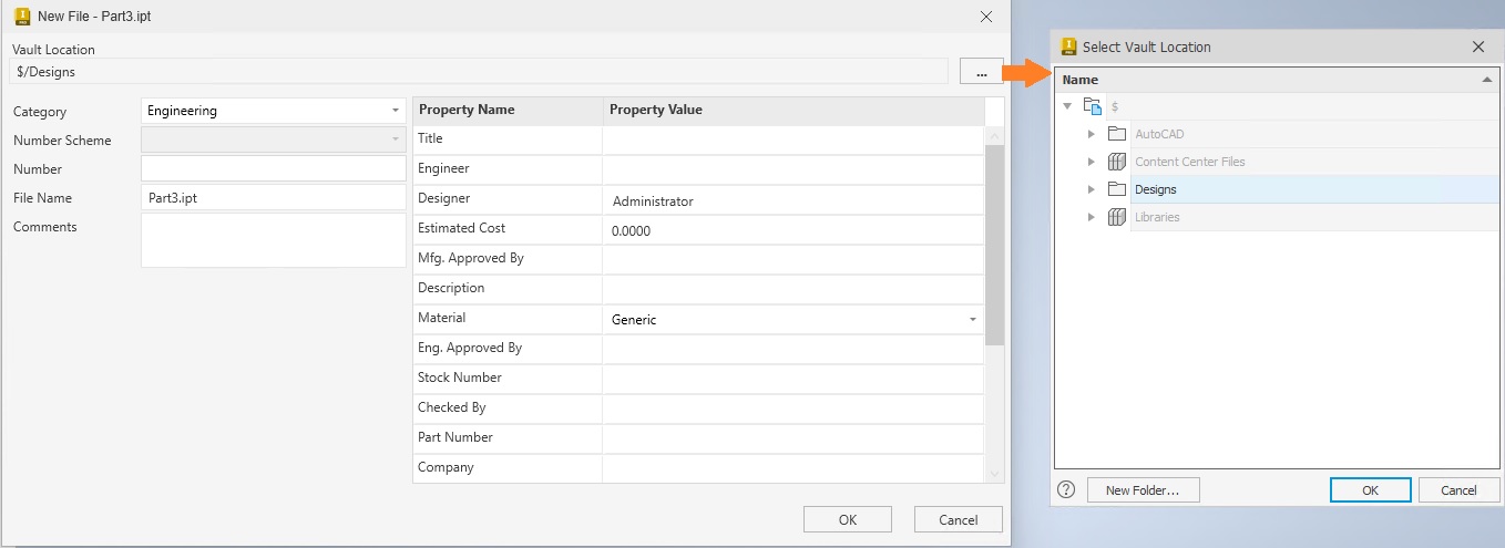

Data Standard for Inventor and AutoCAD replaced the breadcrumb selection of Vault folders with a graphical Select Vault Location browser tree. Along with this enhancement, the ‘Vault Location’ field replaces the local path. The last used location is preset next time a new file is saved.
This helps you to :
- Add Vault location directly as you create and save new file. You cannot save files to locked or inaccessible folders, as they are greyed out.
- Create new folders in Vault while doing the save action.
- Preset the vault location on each new file creation, as the vault location is cached.
