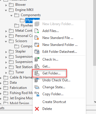

To access the Get Folder command, do one of the following:
- Right-click on a folder in the folder structure panel and select Get Folder.
- Right-click on a folder in the main view and select Get Folder.
- Select the Get Folder command from the toolbar.
- In the main toolbar, click Actions > Get Folder.
The selected vault folder structure is copied from the vault to your working folder.
