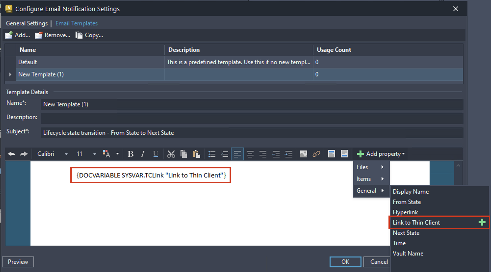

Thin Client URL Property in email template
You can now add or remove the Thin Client URL property in the email template. For more information, see Customize Email Notification Template
