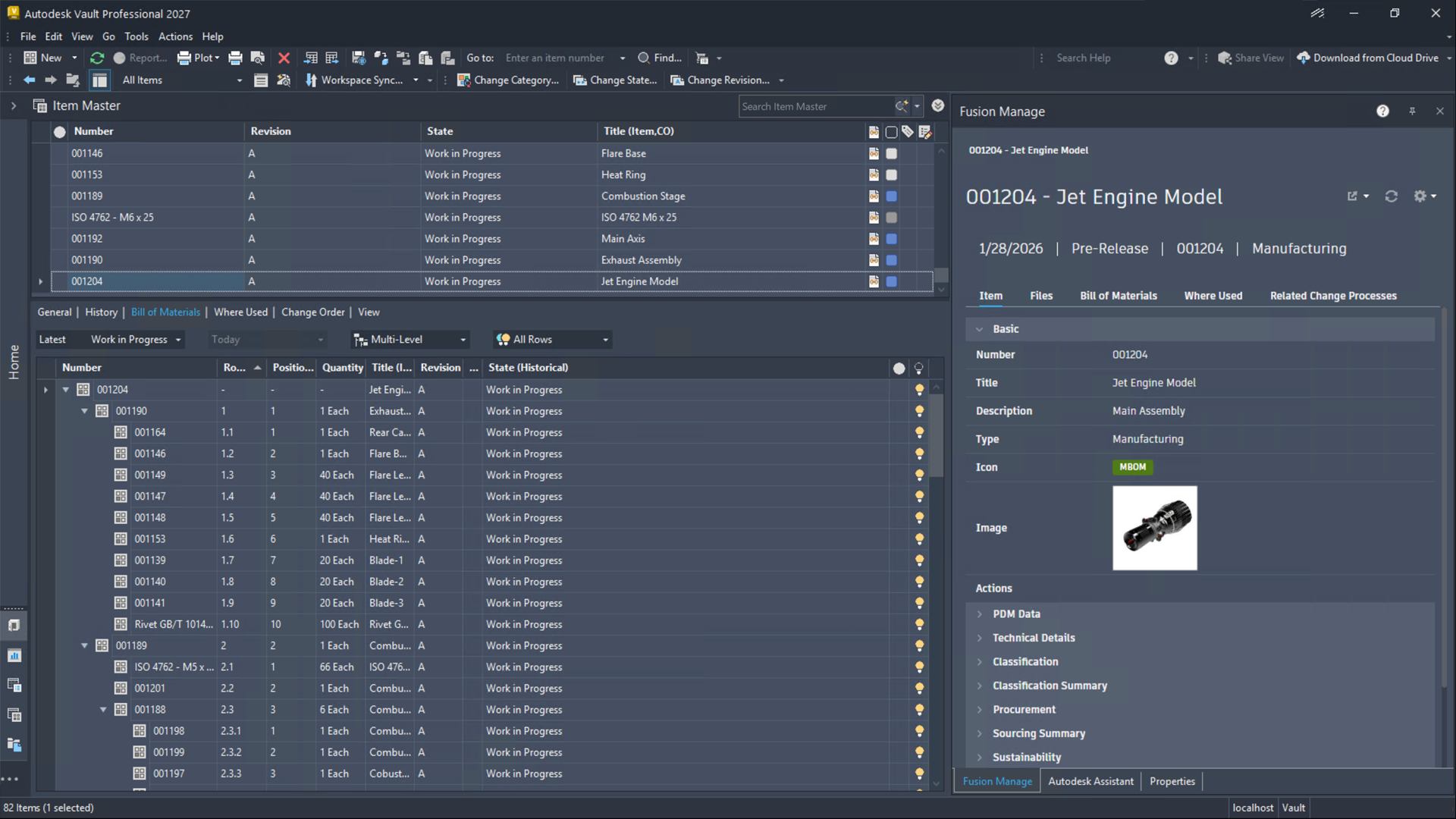

  • Fusion Manage Panel: View Fusion Manage information directly within the Vault client interface, reducing context switching and improving workflow efficiency. The panel displays Fusion Manage Items and their associated data, including Bill of Materials (BOM), Where Used information, related Change Processes, and attachments.
  • Seamless Navigation: Navigate between related objects within the panel and open Fusion Manage Items directly in a browser for additional information, creating a more integrated user experience.
