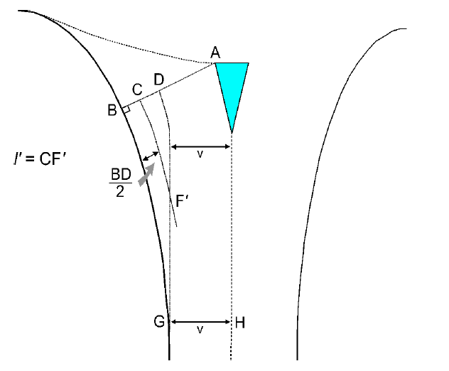

- Effective Flare Length
The Effective Flare Length is the distance l’ in the diagram below.
Note: The Effective Flare Length used by ARCADY for the analysis of mini-roundabouts is the average effective flare length, constructed in the same way as for standard roundabouts but using the MINIMUM approach road half-width instead of the approach road half-width. - Effective Front Axle

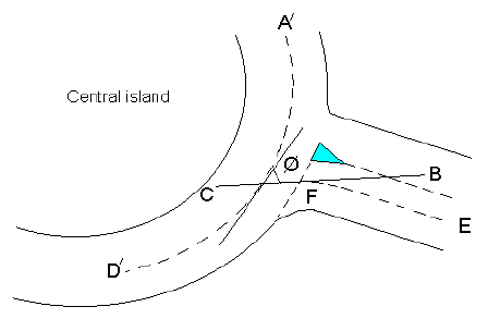

- Entry Angle
- The entry angle or conflict angle, F (phi), is a geometric proxy for the angle between entering and circulating streams. It is calculated in one of two ways depending upon whether the entry and exit tangents intersect with respect to the median circulation path.
When the entry and exit tangents intersect ‘inside’ the circulatory carriageway median, the entry angle is the angle between the entry tangent and the tangent to the circulatory carriageway median at the intersection point.
When the entry and exit tangents intersect ‘outside’ the circulatory carriageway median, the entry angle is half the angle between the entry and exit tangents.
