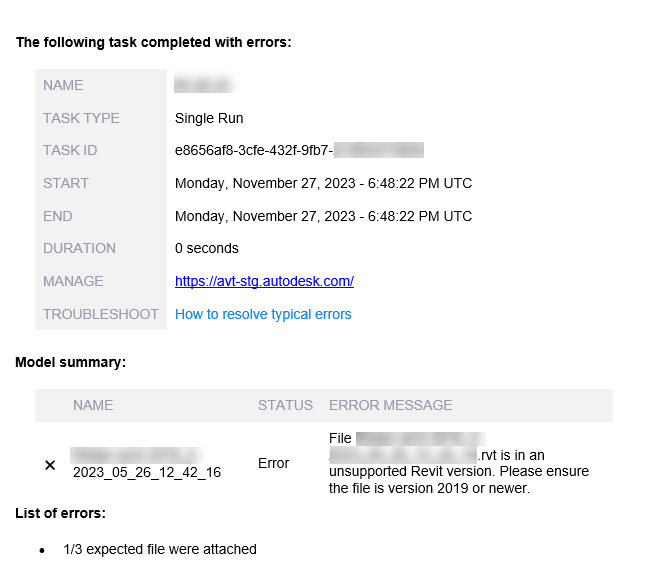

File [documentname.rvt] is in an unsupported Revit version. Please ensure the file is version 2019 or newer.
CONTEXT:
Shown on email under ERROR MESSAGE.
POSSIBLE CAUSES:
- The Revit version is not supported
STEPS TO TAKE:
- In Desktop Revit upgrade to a supported Revit version.

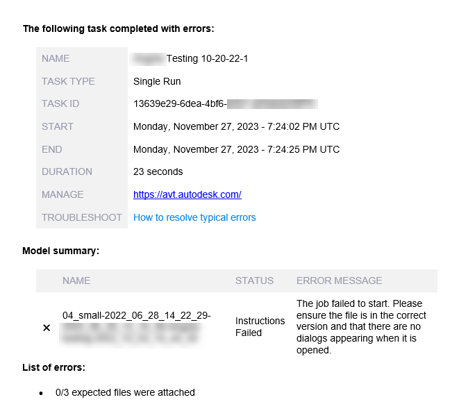

The job failed to start. Please ensure the file is in the correct version and that there are no dialogs appearing when it is opened.
CONTEXT:
POSSIBLE CAUSES:
- Under options, the wrong Revit Version has been selected for the Model.
- A dialog box displays when Model is opened in Revit.
STEPS TO TAKE:
- Ensure the Revit Version of the task is the same Revit Version as the Model
- Open the Model in the Revit Desktop and ensure there are no dialog appearing.

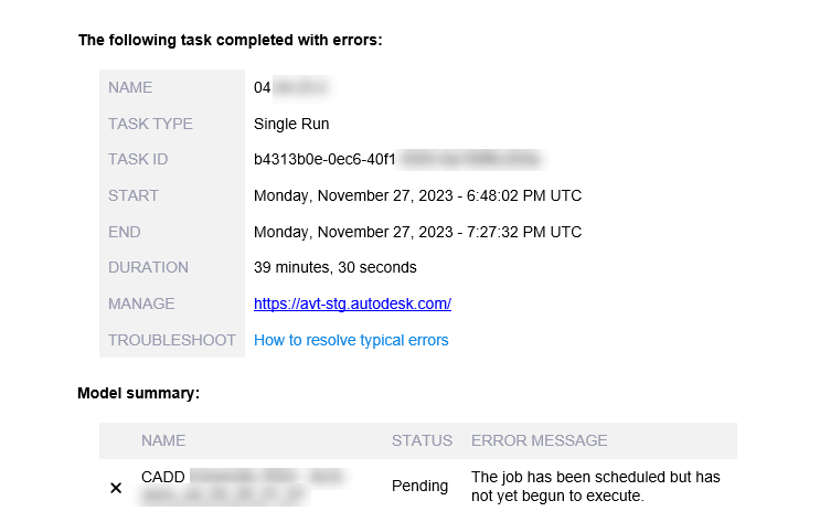

The job has been scheduled but has not yet begun to execute.
CONTEXT:
POSSIBLE CAUSES:
- The Model is not processed in BIM360/ACC
STEPS TO TAKE:
- Check BIM360/ACC to ensure the Model is processed and you can view it on the web.

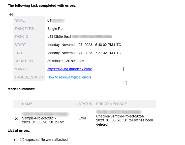

[documentname.rvt] has been deleted.
CONTEXT:
POSSIBLE CAUSES:
- The Model has been deleted/moved from BIM360/ACC
STEPS TO TAKE:
- Check BIM360/ACC to ensure the Model still exists in the task location.

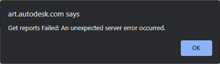

Get reports Failed: An unexpected server error occurred.
CONTEXT:
Pop-up error box when saving a task.
POSSIBLE CAUSES:
- Too much data returned or a data error
STEPS TO TAKE:
- Try running the task again.
- Recreate the task.
