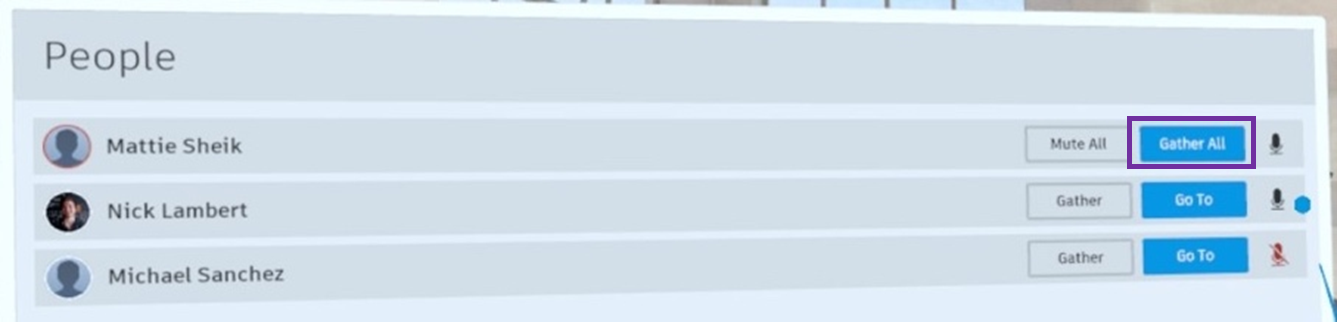

Select People Tab:
Next, look for the 'People' tab, which is situated near the middle of the Core Menu.
Open the People Menu:
Upon clicking the People tab, the Console will open the People menu. Here, you'll see a list of all the users currently participating in the workshop.
Gather All Users:
Finally, click on the 'Gather All' button. This will magically transport all users in the workshop to your current location!
