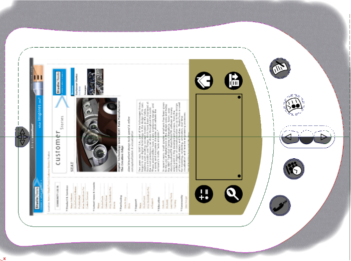

This example image use sketch projection for the small PDA button icons, PDA display, and red sketch. The scene is rendered using Alias RayTracing.

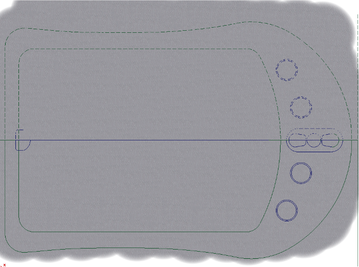

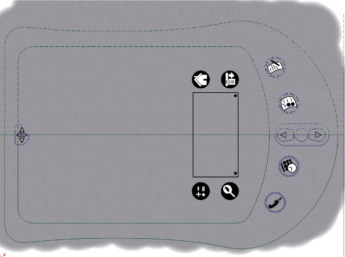

  3. Create curves to define the design primary design components. In this example, we have assigned these curves to a 3D layer and made this layer symmetric.
  4. Create more curves that define the icons and create paint shapes from these curves or import standard company graphics.

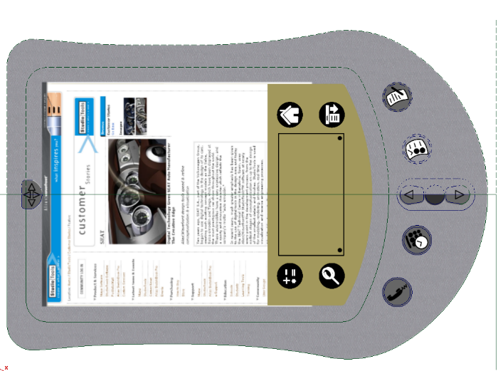

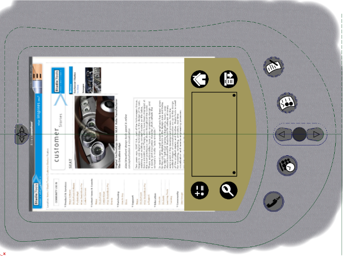

  5. Import a graphic design page for the PDA screen.

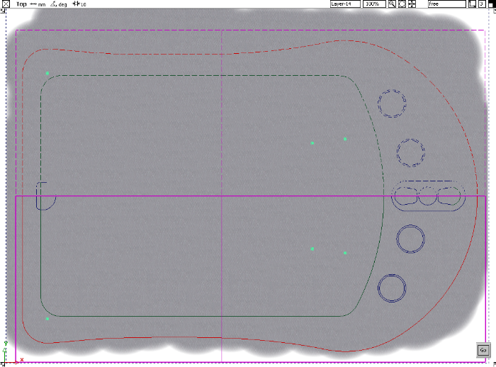

    Next, clean up the appearance of the gray base plastic layer. We could use a mask layer and delete the plastic outside the main PDA body, but in this case, we will use an invisibility mask shape to hide the paint on this layer.
    Make sure the current layer is the plastic body layer that was painted with the texture brush.
  6. Choose Paint > Shape > Make Invisibility Mask Shape. You are prompted to select the curves, then click Accept.
    The image below shows how the invisibility mask shape has hidden the paint inside the curves.
  7. In this example, this is not what we want, so choose Edit > Invert Layer in the Canvas Layer Editor.
    The image above shows how the plastic paint layer now only shows paint defined by the invisibility mask shape. The advantage to this workflow is the paint will be automatically hidden or shown as the curves are modified. If we had used a mask layer and erased the paint with a brush, it would require a significant amount of work to repair the layer.

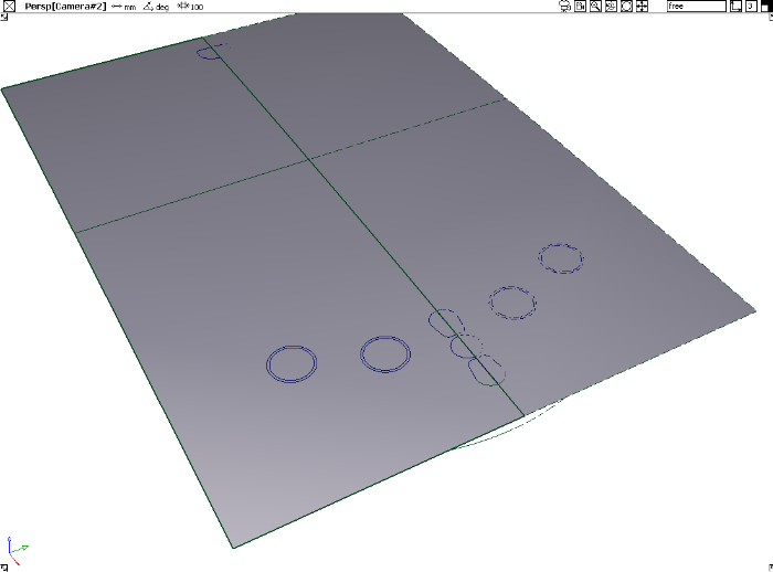

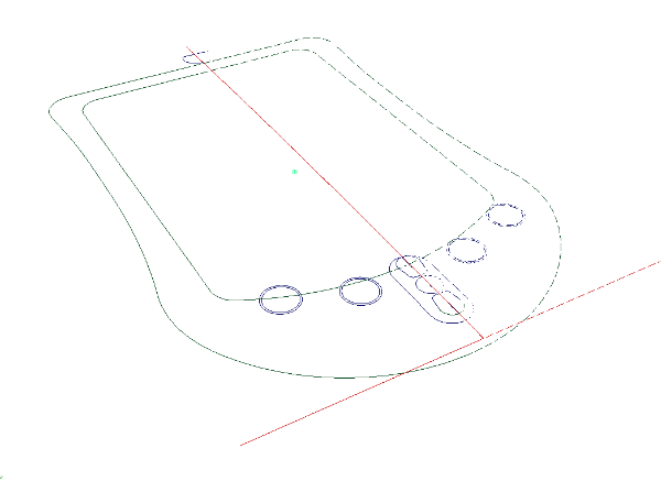

Develop a surface for the model
  1. Create two curves to define the top surface of the PDA.
  2. Extrude a surface along these curves highlighted in red.

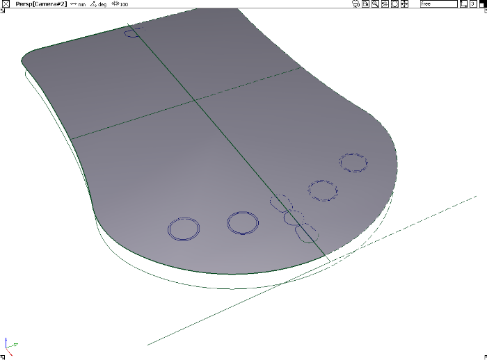

    You now have built the primary surface for the PDA top.
  3. In the Top window, choose Surface Edit > Create CurvesOnSurface > Project to create curves on surface.
  4. Use Surface Edit > Trim > Trim Surface to cut away the top surface and discard the outer edges.

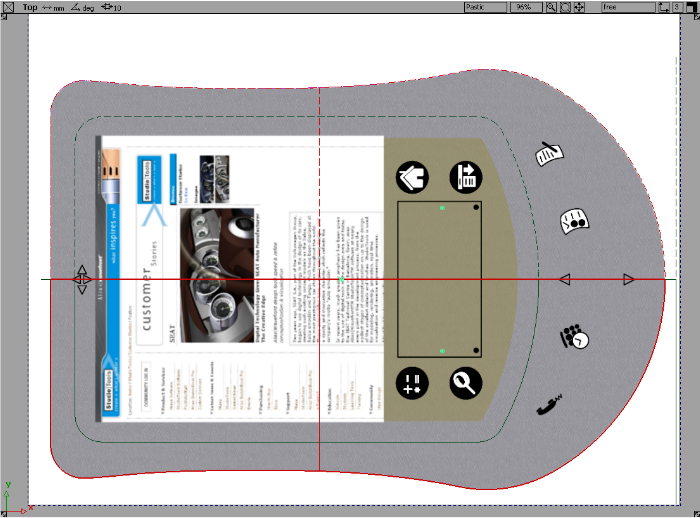

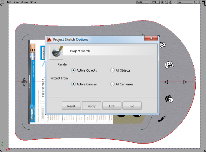

Project painted details on a simple model
From the Top view, we can quickly project paint onto the top surface.
  1. Select the surface you want to project paint onto.
  2. Open the option windows for Canvas > Project Sketch. This tool supports projection of paint from a number of views and onto active or all surfaces.

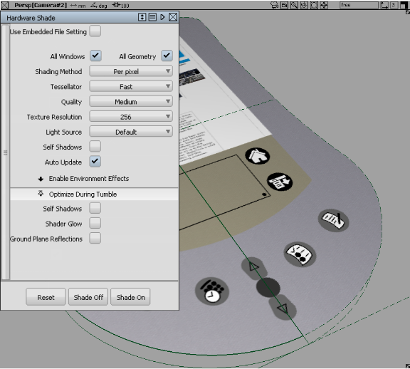

  3. Change windows to the Perspective view and open WindowDisplay > Hardware Shade to toggle shade on.
  4. Tumble the scene in real time to view this very simple concept surface.
  5. At this stage you can reposition the graphics, then update the sketch projection either using the menu in the canvas layer editor or by repeating the sketch render process.
