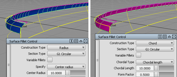

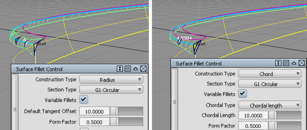

The Construction Type and Variable Fillets options let you choose how the tool creates the fillet surface:

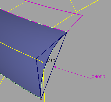

The chordal length is the length of the straight line that joins both sides of the fillet, at a given U parameter value.
Constant Radius and Chord fillets.
Variable Radius and Chord fillets.
