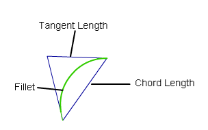

Chordal length – a chordal length is specified in the field below.
Tangent length – a tangent length is specified in the field below.
This option is only available when Construction Type is Chord.
The distance to maintain between the two sides of the fillet, or the length of the tangent segment (see picture above).

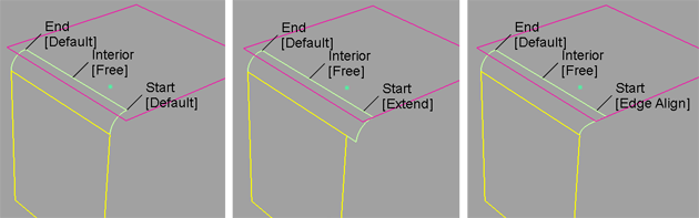

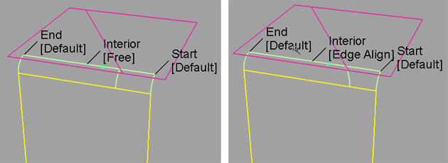

Controls how the fillet surface(s) edges (in the V direction) meet up with the edges of the boundary surfaces.
Edge align – The tool tries to colinearly align the fillet surfaces’ edges or isoparms (for single surface) to the edges of the boundary surfaces in the V direction.
Extend – The fillet is extended so that it reaches to the end of the longest boundary surface, at its start and/or end.
Default or Free – The edges (in the V direction) of the fillet meet the boundaries at a 90 degree angle.
Clicking the labels on the model lets you cycle through all the possible values.
Possible flow control values for Start of fillet
Possible flow control values for Interior of fillet

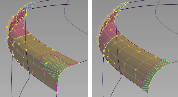

Displays a curvature comb plot across the resulting surface.
Displays a manipulator indicating continuity achieved with the existing surfaces along the fillet edges.
