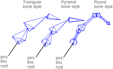

Select the root of the skeleton that is to be copied.
Choose Animation > Tools > Bone Style
to specify bone style.
The following illustrations demonstrate the various bone styles.

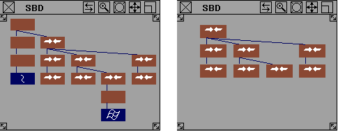

Two skeletons have the same topology if each joint node of Skeleton 1 has the same number of direct descendants joint nodes as Skeleton 2. In the following SBD window diagrams, Skeleton 1 and Skeleton 2 are topologically equivalent.
These diagrams show that skeletons with the same topology can have non-joint DAG nodes grouped anywhere above, below, or as siblings to joint nodes. In determining the skeleton from the DAG node hierarchy, the non-joint DAG nodes are ignored.
Sometimes two skeletons can have the same topology, but differ in the significance of their topology. For instance, two skeletons could have two branches of three grouped joint nodes, each branch representing the hip, knee, and ankle joint of a leg. The difference is that in one skeleton, the first branch represents the right leg, and in another, the first branch represents the left leg.
If Overlay skeleton is used to copy animation from one skeleton to the other, the animation of the left leg is copied to the right leg, and vice versa. To make sure that the animation is copied to the appropriate respective branches, use the SBD swap icon (located in the SBD window title bar) or an
-arrow (Windows) or
-arrow (Mac) combination to swap the positions of the branches in the SBD window.

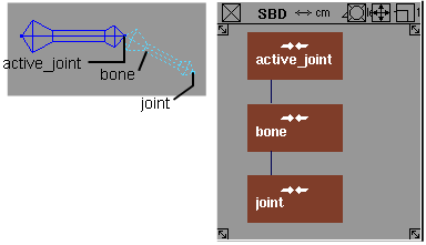

As you create each joint, a DAG node is added to the Scene Block Diagram (SBD) and a bone is drawn in the modeling windows connecting this joint to the previous joint.

Each time you click in the modeling window when using New skeleton, you create a new joint node that is a child of the active joint node, and a bone is drawn between the two joints.
Each time you create a joint DAG node in this way, the pivot position of the joint DAG node is placed where you last clicked in the window. (You can also create a new joint DAG node by entering the pivot position on the keyboard.)
Bones are drawn between joint nodes and their nearest ancestor joint node by connecting the rotation pivot points of the two nodes. You can change the shape of the bone (see Animation > Tools > Bone Style

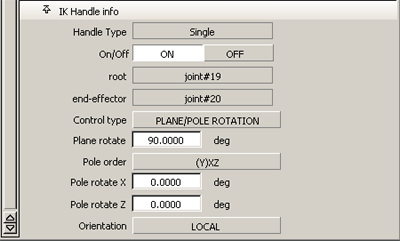

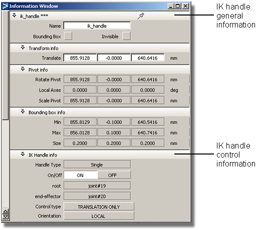

Use the Windows > Information > Information Window menu item to display the details.
The name of the IK handle. You can edit this field.
Turns off the display of the IK handle’s bounding box.
Turns off the display of the IK handle.
The handle’s translation coordinates. These are the only editable coordinates at this time because under Control type, TRANSLATION ONLY is chosen. The rotation and scale are not used to control the handle’s behavior.
The handle’s rotation pivot coordinates.
The handle’s local axes coordinates.
The handle’s scaling pivot coordinates.
The limits placed on the handles’s bounding box, which is made up of the Limb axis and Plane indicator.
The size of the bounding box. Size = Max - Min.
The type of the IK handle: single, multi, or spline.

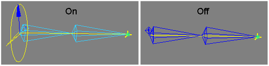

Click these buttons to turn the IK handle on or off. When the handle is turned off, it is still visible but has no effect on the IK chain. To hide it completely, click Invisible at the top of the IK handle section.
The top-most joint in the skeleton hierarchy affected by the IK handle.
The bottom-most joint in the skeleton hierarchy affected by the IK handle.

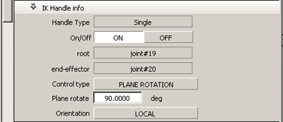

A single-chain IK handle has three levels of control accessed from the Control type pop-up menu.
The Pole order field is used to determine which two degrees of freedom are to be used to rotate the Pole Axis. In the earlier example illustrating plane rotation, the skeleton was drawn in the XY plane. Thus the Pole Axis is automatically positioned along the Z-axis (that is, perpendicular to the skeleton plane) when the IK handle is created, and the pole order is ZXY. This means that the Pole Axis is created parallel to the IK handle’s Z-axis (and thus given the blue Z-axis color), and its orientation is adjusted by applying a local X rotation, then a Y rotation, to the Pole Axis.
The IK handle solution orients itself to a coordinate system to work. The coordinate system matches either the joint (LOCAL) or scene (WORLD) orientation.
If the IK chain never needs to change orientation from its rest position, the default Translation Only setting will be all you need to animate the skeleton. For example, if the legs of a simple biped character in a walk cycle are oriented in a constant direction (that is, the knees always point forward), the IK handles for the legs will only need translation.

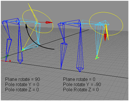

However, if that same biped character needs to have a “bow-legged” or “knock-kneed” appearance or if the character is dancing, you might want to rotate the skeleton plane of both legs to achieve this effect. In this case, choose the Plane Rotation setting for those handles in the Information Window, and adjust the Plane Rotate fields accordingly.
You will need to adjust the rotation of the Pole Axis, through the “Plane/Pole Rotation” setting, only if the skeleton chain is to be animated through an extremely wide range of motion in the scene. Specifically, if the limb axis of the chain comes near the Pole Axis, an undesirable “flipping” of the chain may occur; generally, you will want to move/animate the Pole Axis so that the handle’s limb axis does not come too close to it during a given scene.

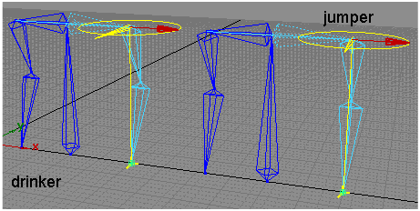

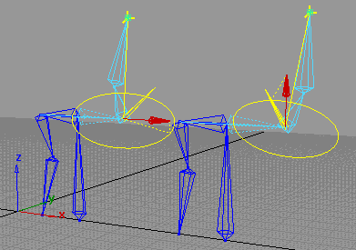

When you create a single-chain IK handle on a chain, a Pole Axis is created perpendicular to the skeleton plane in its rest position. As long as the chain is not contorted very far from this position, and the limb axis of the chain doesn’t approach the Pole Axis, this default position of the Pole Axis is suitable for animating the skeleton. Otherwise, adjusting or animating the Pole Axis may be necessary to avoid flipping in the chain.
Below is an example of two torsos and how different types of arm movements are achieved through POLE/PLANE ROTATION.
In this example, the two torsos are identical and both have IK handles on the left arms. The default value for Plane rotate is 90 degrees. The default value for Pole rotate Y and Z is zero degrees. The left torso requires a drinking motion, while the right torso will perform a jumping motion.

Turns on or off IK handles so that they become enabled or disabled.
You can do the following:
When an IK handle is OFF, it behaves as if it does not exist. You can not select it. An individual IK handle can be turned ON or OFF from the Information window.
