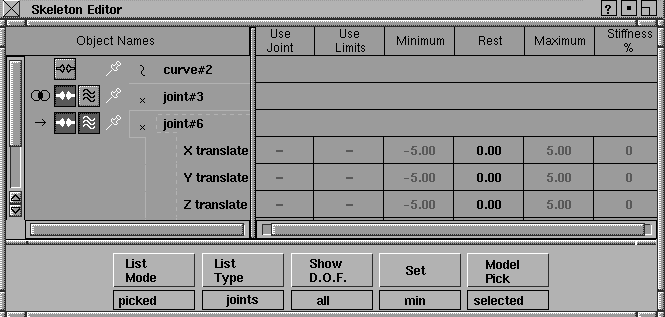

  1. Create a joint node hierarchy withAnimation > IK > New Skeleton.
  2. Choose Animation > Editors > Skeletons to open the Skeleton Editor window.
Use the Skeleton Editor to create and modify joint DAG nodes and skeleton hierarchies, and to tailor joint limits, and other properties of an IK chain.
The Skeleton Editor has two sections. On its left side is a lister containing the names of DAG nodes; on the right is a spreadsheet listing the properties of each joint.
Skeleton Editor lister
The contents of the lister depend on the selection made in List Mode. Each element in the list has up to four icons, plus a DAG node icon and DAG node name.

Skeleton Editor spreadsheet

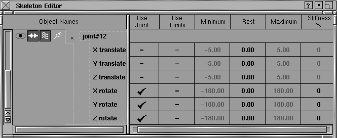

The right side of the Skeleton Editor is a spreadsheet of values that you can edit for different joint node components. (You can edit values only for joints. Before you can edit other objects in this window, you must change them to joints.)
Select the joint expansion icon for one of the joint nodes to see the values for these joints in the spreadsheet. The values for each of the joints in the spreadsheet are used by single-chain or multi-chain IK handles.
This screen shows the Skeleton Editor with the Show D.O.F. menu set to All.
Select Use Joint and Use Limits column entries in the spreadsheet to set them ON (shown by a check mark) or OFF (shown by a dash).
Use Joint
If set to OFF, the parameter does not change during a transformation. This is useful for restricting the motion of a joint. For example, in a skeleton hierarchy of a leg, you may restrict the knee joint so that it can only bend along the x-axis. Therefore, the Y and Z rotations for Use Joint should be OFF.

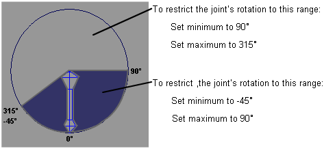

Use Limits
If set to ON, the joint uses the limits defined in the next two columns, Minimum and Maximum, during transformations. This is useful if you want a joint component to move within a specified joint range. For example, a joint node representing an elbow may have a desired range of 0 to 170 degrees. If Use Limits is ON, and these range limits are set, the elbow joint does not take a value outside that range during a transformation.
If set to OFF, any joint limits set for that joint are ignored. To show this, the Minimum and Maximum cells are grayed out and non-editable.
To define limits, see the description of the Set Button in the Set menu section.

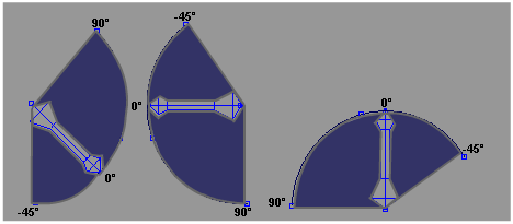

0 degrees is determined with respect to the direction in which you drew the bone originally. If you drew the bone at a slant, the minimum and maximum ranges in the previous example would appear as shown in the following.
Minimum/Maximum
These two columns can take any values. The values represent the minimum and maximum values for a joint parameter. For rotation parameters, the values are angles in degrees. For translation parameters, the values are in centimeters. Click in the column on the row of the joint you want to change, and set the minimum or maximum joint value.
Note:
You can also set the minimum and maximum joint values using the Minimum and Maximum Set menu.
Restrictions are that the minimum value must be less than the maximum value, and the rest position must be between the minimum and maximum values. If you enter a minimum value that is greater than the maximum, or if you enter a maximum value that is less than the minimum, the minimum and maximum values are exchanged. If Use Limits is on, these minimum and maximum values restrict the range that a joint parameter can assume.
Stiffness Percentage
This column contains values between 0 and 100, which represent the percentage stiffness for each joint parameter. When dragging a chain with a multi-chain handle, there are usually many possible solutions for the chain to reach its goal. Applying stiffness to some joints provides greater control over how the chain reaches its goal.
For example, if you are animating an arm reaching for an object, making the shoulder joint really stiff makes the arm bend at the elbow to reach the object. However, making the elbow joint really stiff keeps the arm straight, and forces the whole arm to reach for the object.
A value of 0% means that there is no stiffness applied to that joint, and it will move as quickly as it can to help the chain’s effector reach its goal. A stiffness of 100% constrains the joint completely, and produces the same effect as not using the joint at all (that is, as if Use Joint is OFF).

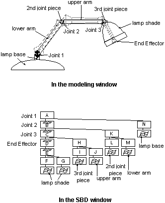

Example of Hierarchy, Below, and Above
The Hierarchy, Below, and Above modes are useful if you have already created a hierarchical model and want to use inverse kinematics to move or animate it. Any DAG node in the lister can then be interactively toggled to a joint by clicking on the joint button in the lister.
These modes can also be used to limit the information in a hierarchical list to parts of the skeleton you are working on.
The following example shows a desk lamp and its skeletal hierarchy:

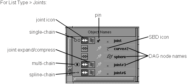

Joints
The joints are listed hierarchically.

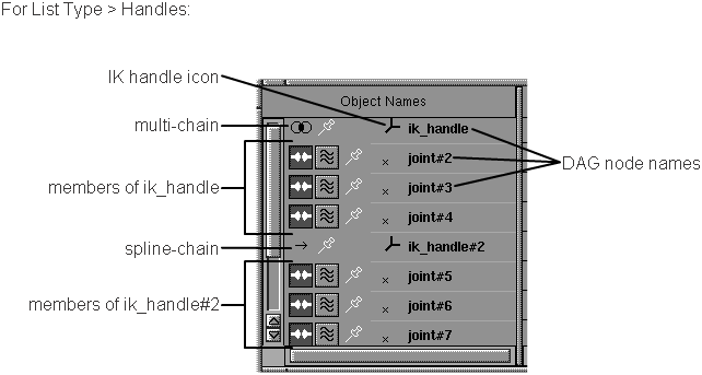

Handles
The joints are listed by IK Handle.

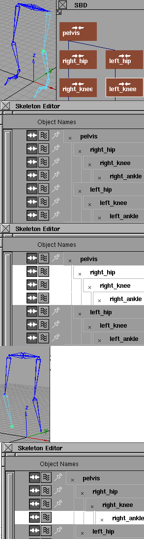

An example best demonstrates how this works. Suppose you have created a two-legged figure:
  1. Pick the left_knee joint node in the modeling world.
  2. Choose List Mode > Skeleton in the Skeleton Editor. The Skeleton Editor lister now contains a hierarchical listing of the joint nodes for the two-legged figure.
  3. In the Skeleton Editor lister, select all the joints in the right leg (right_hip, right_knee, right_ankle).
  4. Choose Model Pick > Selected.
    Since the left knee is not selected in the lister, it is unpicked in the modeling world. Since there is a pick conflict between the joints in the right leg, the lowest joint is selected (right_ankle), and is picked in the modeling world. The other joints in the right leg are unselected in the lister, since they could not be picked in the modeling world.
