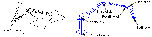

Create a simple spine chain
Bone chains are not limited to living creatures. A desk lamp is a simple bone chain. Using a chain of bones, you can easily create a lamp by clicking and forming sections from the base of the lamp to the shade.

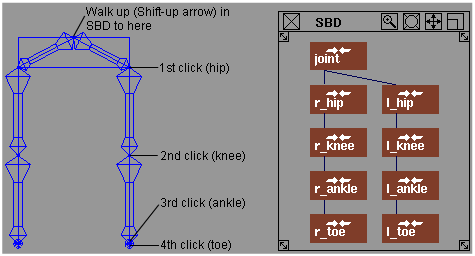

To draw the left leg
To make the left leg, you want the next joint DAG node you create to be a child of the pelvis node.
  1. Use the -Up arrow combination to move up the hierarchy until the pelvis is active. You can do this in either the SBD or modeling window.
    You can also create the left leg by using Edit > Duplicate > Mirror.
  2. Click to define the position of the left hip, knee, ankle, and toe as you did with the right leg.

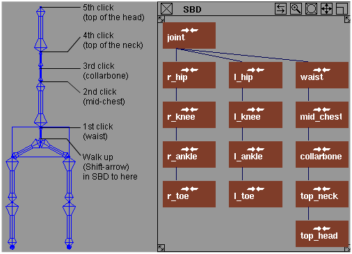

To draw the spine and the head
  1. Use -Up arrow to move back up the hierarchy to the pelvis and draw the spine, neck, and head.

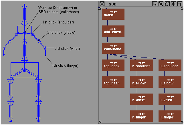

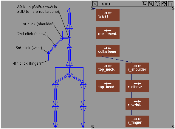

To draw the right arm
  1. Use -Up arrow to move back up the hierarchy to the collarbone, and draw the right arm.

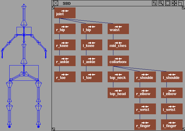

To draw the left arm
  1. Use -Up arrow to move back up the hierarchy to the collarbone, and draw the left arm.
    For more information about skeletons, see Animation > Editors > Skeletons.
  2. You now have a finished skeleton.

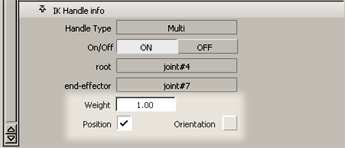

When a multi-chain IK handle is picked, the IK Handle info section in the Information Window has three items not seen with single-chain IK handles:
Weight
A numerical value that determines the influence of this handle relative to other handles in the skeleton chain.
Position
When checked on, the handle is used to determine the position of the end-effector of the skeleton.
Orientation
When checked on, the handle is used to determine the orientation of the end-effector’s parent joint.

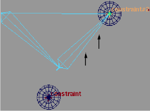

Overlap IK handles
With the multi-chain IK solver, you can overlap IK handles. For example, on an arm, you can place an IK handle from the shoulder to the wrist, and a second handle from the shoulder to the elbow.
By default, overlapping IK handles will have equal influence on the IK chain.
In the following example, if the shoulder-elbow handle is pulled downward at the same time the shoulder-wrist handle is pulled upward, the arm assumes a position that tries to meet both handles equally:
If you prefer one handle’s influence to be greater than the other’s, you can adjust the handle’s weight in the Information window. In this example, if you want the shoulder-elbow IK handle to have only a small influence, you would set the IK handle weight to a small value (for example, 0.1). As a result, the arm skeleton tends to favor the shoulder-wrist handle, as shown below:

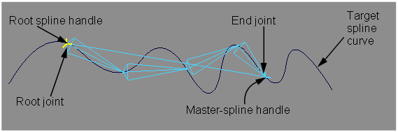

Spline IK overview
A spline handle is defined on a skeleton chain by a root joint, an end joint, and a target spline curve.
Like single-chain IK handles, spline handles are constraints affecting skeletons. They do not overlap.
When a curve is transformed or animated, the skeleton chain tries to match it. You can also transform or animate the root handle’s position or rotation to change the chain’s position, rolling it along the curve. Rotating the master handle twists each joint on the chain. If you point-constrain the root joint to an object, the start position of the chain is constrained.

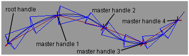

Master and root handles
There are two kinds of spline handles.
If a master spline handle controls a skeleton chain without a root handle (the root handle may not be created or may have been deleted), the root joint remains fixed, and only the reachable part of the chain follows the spline curve. A tail is a good example; it stays attached to a body, while its end is free to be dragged along a curve. A root handle cannot exist without a master handle.

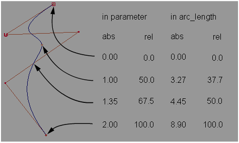

Parameters and arc lengths
Spline handles can define positions on a curve either by parameters or by arc-lengths. Both types of measurements use relative percentage values.
The following figure shows points on a spline curve defined by parameter distance and by arc-lengths. Each point in this figure is represented by four values: an absolute parameter value, a relative percentage parameter value, an absolute arc-length value and a relative percentage arc-length value.
For each spline handle, we can use only relative parameter values and relative arc-length values to define the points or positions.

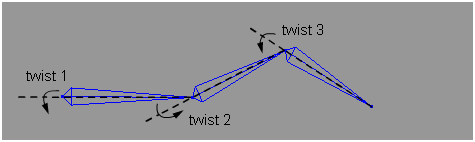

Twisting the chain
To twist the chain means to rotate each joint (except the end) on the chain using each joint’s lower bone as the rotation axis. If the master handle has its Twist Root attribute set ON, the twist starts from the root joint; otherwise it starts from the second joint.
There are four different twist-types that you can use to control the spline handle. (See Twist Type in the Information Window for more information.)

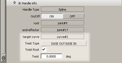

Master handle information
For a master handle, you can change the twist type and the twist angle from the Information window.
Target curve
The spline handle’s target curve.

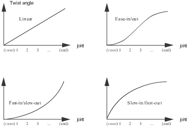

Twist Type
The master spline-handle solution has four types of control which you can specify from this pop-up menu:
  • Linear — the joints twist equally at each joint.
  • Fast Out Slow In— the joints near the root twist more than the joints near the end.
  • Slow Out Fast In — the joints near the root twist less than the joints near the end.
  • Ease Out Ease In— the joints in the middle twist more than the joints at the two ends.
Twist Root
Set ON to let the twist start from the root joint. Otherwise, the twist starts from the second joint.
Twist
You can set the Twist degree by typing the degree number in this field. You can interactively change the degree value by scrolling using both the (Windows) or (Mac) key and the .
