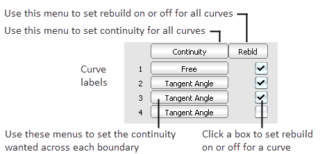

The Continuity Table displays one row for each boundary curve involved in the Square operation.
  • Use the pop-up menu next to each curve to set the level of continuity you want across that curve.
  • Use the Continuity pop-up menu above the table to set the continuity you want for all of the curves at once.
  • Click the checkboxes at the end of each row to rebuild the curves to reduce data and improve parameterization.
  • Use the Rebld pop-up menu to set rebuild on or off for all the curves at once.
