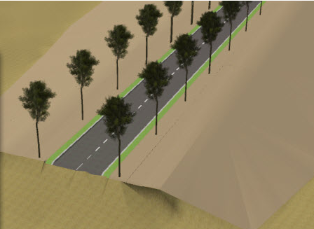

To use InfraWorks 360 road style along the Civil 3D corridor centerline alignment, leave both Road Options unselected. You can use the rule styles or the Style Palette to apply InfraWorks 360 road styles to the imported road. With neither of the Road Options selected, the imported road will look something like this:

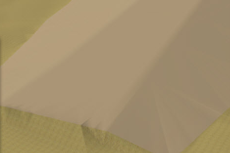

To ignore the InfraWorks 360 road styles and show the road surface as a coverage area, select this option. With this option selected, the roadway will look something like this:

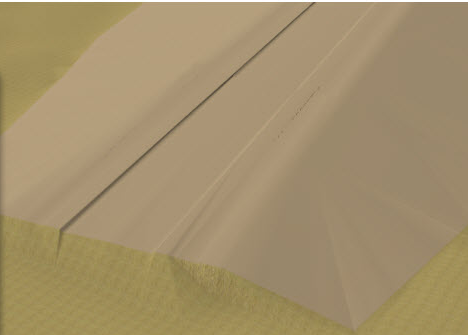

If you selected the first option, this option becomes available. If you select it, the roads will display the Civil 3D corridor top surface in relief. For example, roads will include raised and lowered areas that represents curbs, and so on, but will not use the underlying corridor surface. This state can be used to work around visual problems that are sometimes caused by the corridor surface covering a larger area than necessary and having large flat triangles on its boundary.
With both options selected, the roadway will look something like this:
